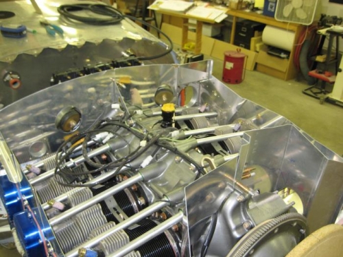

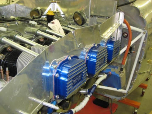

Engine Baffling
1612 - 1818

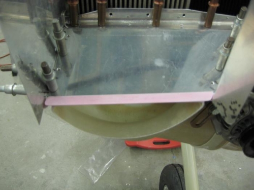

Remove inlet ramps, remove packing tape.
Remove intake plenums.
Debur and smooth f/g lip, sand to shape.
Install plenums and ramps.
Install #5 and #6 rear baffles. This required some trimming around the rocker covers and the upper aft case.
Clamp baffles to baffle support, match drill #12 holes, cleco as drilled.
Install #3 and #4 baffles, trimming as needed around the rocker covers.
