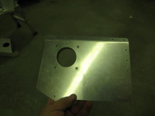

Locate and mark position of left inlet ramp heat duct flange.
Drill hole using hole saw, debur and smooth.

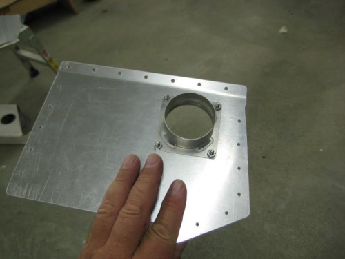

Match drill flange mount holes in ramp.
Debur and machine c-sink for 6-32 screws. I decided to use flush screws in order to facilitate changing a damaged duct screen, if necessry. This prevents the need to drill rivets out when replacing the screen.

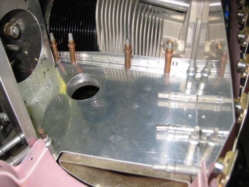

Temporarily install inlet ramp, verify fit.
