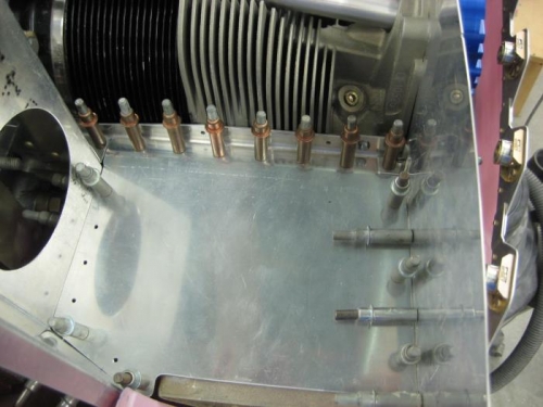

Brief Description:  Engine Baffling
1430 - 1730 1830 - 2030

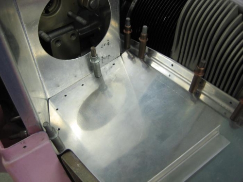

Continue work on the left side front baffle and ramp.
Trim #2 baffle for attachment of ramp mounting angle.
Fabricate mount angle. verify fit.

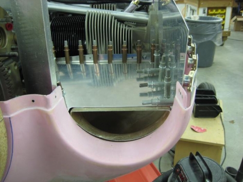

Match drill baffle and ramp to mount angle, cleco as drilled.
Trim ramp to provide adequate clearances and allow for fiberglass lip.
Cleco ramp in place, verify fit.
Fabricate small support angle corner brace as the stock one will not work due to the increased thickness of the ramp support assembly. Brace was fabricated from 3/4 x 3/4 aluminum angle, match drilled, deburred and smoothed.
Cleco brace in position, verify fit.
