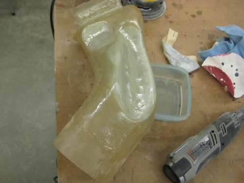

Remove right intake from engine, remove packing tape from cylinder head, remove balloon from intake.
Prepare exterior of right intake plenum for finish layer of 9 oz cloth using permagrit tools and s/p.
Clean surface, prep for f/g.

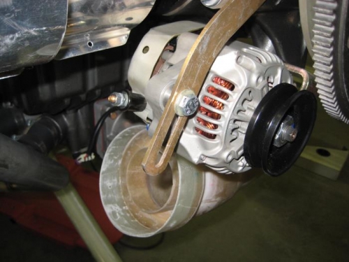

Install right intake, verify fit.
Install re-clocked alternator, verify fit. The new B lead clock position will work well.

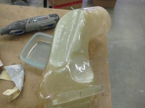

Mix epoxy, wet out cloth.
Apply f/g as previously detailed.
