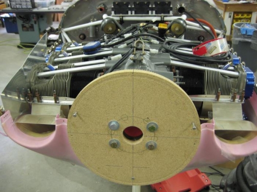

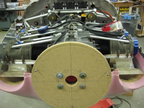

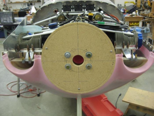

Remove cowl.
Remove intake plenum assembly.
Match drill three equally spaced holes in left intake flange, cleco as drilled.
Remove clecos.
Slip left intake plenum from center plenum.
Remove vinyl from flange.
Sand and smooth new plenum flange.
Install center plenum and intake plenums.
Install cowl, verify fit.
Make initial cuts to #2 baffle.
Using f/g flanged sheet from showplanes, fabricate intake plenum forward mounting plates.
Match drill plates to #1 and #2 baffle mounts.
Adjust f/g mounts until satisfactory fit was attained.
Mix epoxy, wet out 2" and 3" tape.
Apply 4 layers of f/g tape between intake plenum and f/g flange mount sheet.
Verify fit of plenums to cowl.
