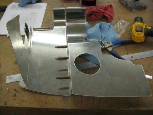

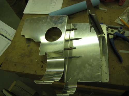

Brief Description:  Engine Baffling
1300 - 1418 1518 - 1718
Remove temporary joiner in center plenum.
Rough sand exterior of center plenum to remove f/g strings.
Install center plenum.
Install lower cowl.
Verify fit of center plenum with cowl. Check approximate location of side plenums.
Continue trimming, deburring, and smoothing of baffle pieces.
Cleco doublers to #6 baffle. Final dril.
Remove clecos, debur holes. Dimple per plans.
Rivet doublers per plans using p-squeezer.
Adjust #6 baffle, verify fit.
Cleco aft baffles together, final drill common holes.
Final drill tension rod holes using #27 drill.
Cleco #6 baffle doubler in position, final drill.
Rivet doubler per plans using p-squeezer.
NOTE: I purchased the baffle kit from Van's. The VA-187 4" duct flange IS NOT INCLUDED in this kit. Really? Installation of this flange is like step 3 and it would be difficult to proceed without installing it. It should be included in the kit.
