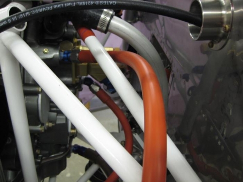

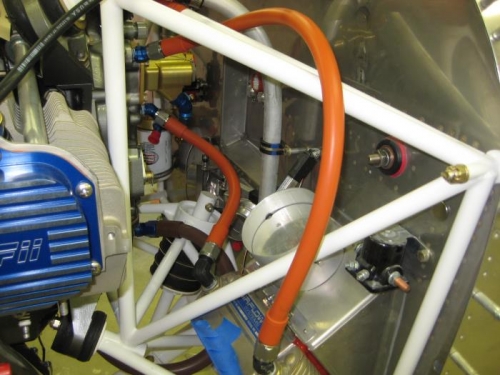

Brief Description:  Install Oil Cooler Lines
1730 - 1830
Remove Straight Oil Nipple from engine.
Install AN823 45 degree nipple using Loctite 567 thread sealer.
Install oil cooler lines between AN fittings.
All lines were made by Tom at TS Flightlines.
