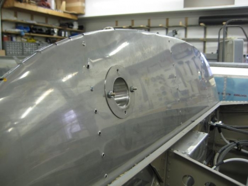

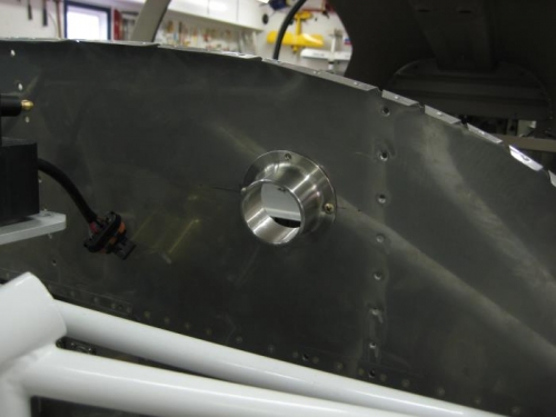

Install Firewall Pass Throughs
1506 - 1630
Debur and smooth punched holes in firewall.
Fabricate pass through doubler from 050 stainless steel.
Drill and punch center hole.
Clamp SS flange to doubler blank, center on hole.
Match drill doubler to flange.
Debur all holes.
Cut shape and smooth perimeter of doubler.
Install pass through temporarily, verify fit.
