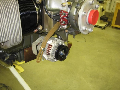

Install Alternator
1654 - 1754
Install B&C 60 Amp Alternator per instructions.
It was necessary to remove the ignition sensors to facilitate installation of adjustment arm bolt.
Sensor bracket removed, bolt installed, bracket reinstalled and nuts torqued.
Install alternator pivot bracket, torque bolts and bend safety tabs against nuts.
