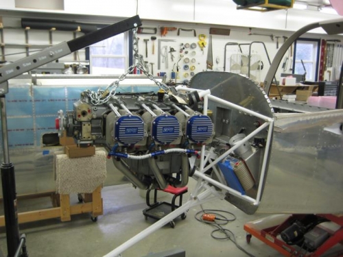

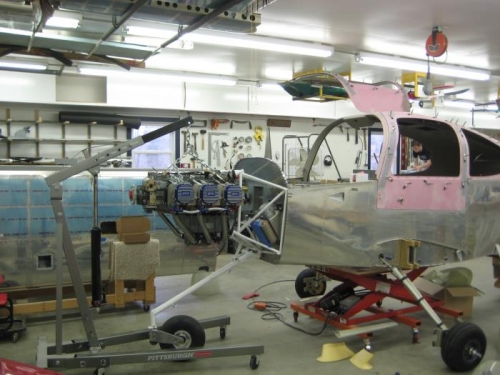

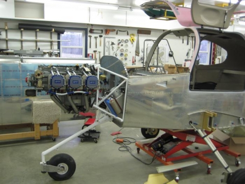

Install BPE - IO540X.
Engine was lifted into position using engine lift.
Install J-3804-20 Lord Mounts with spacer.
Position engine and install motor mount bolts per Vans. This was a bit of a challenge as the fourth bolts was difficult to align. A call to Barrett helped. I ended up snugging the 3 bolts down to draw the engine into the mount. Then, I had to loosen the bolts a bit to get the fourth bolt to line up. Finally got the bolt through and the nuts on.
Torqued bolts to 450 - 500 inlbs and inserted cotter key.
Remove engine lift.
