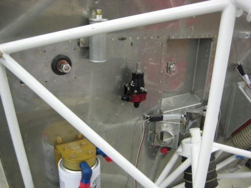

Brief Description:  Install Fuel Pressure Regulator
1624 - 1824
Attach regfulator bracket to firewall using AN3 bolts.
Attach regulator to bracket with supplied cap screws, lock washers and blue loctite used.

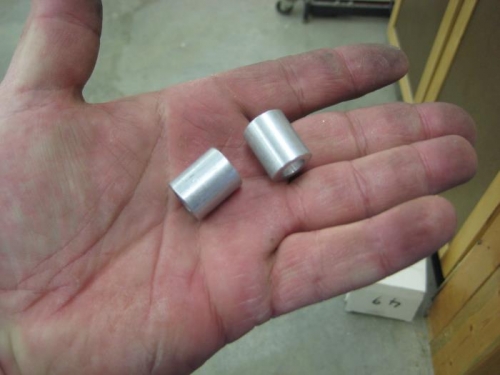

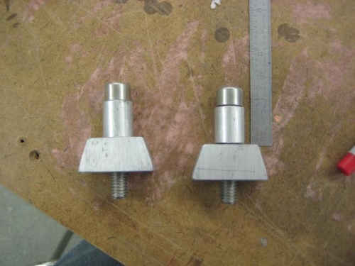

Fabricate two 5/8 x 3/4 spacers for nose gear towbar bolts. This quick modification will allow up to 1 1/4" engagement in the Bogi-bar towbar and prevent damage to the wheel pant by preventing the towbar from slipping off the original cap screws.
Cut the standard trapezoidal spacers to approximate height using bandsaw.
Mill trapezoidal spacers to correct height using Smithy.
