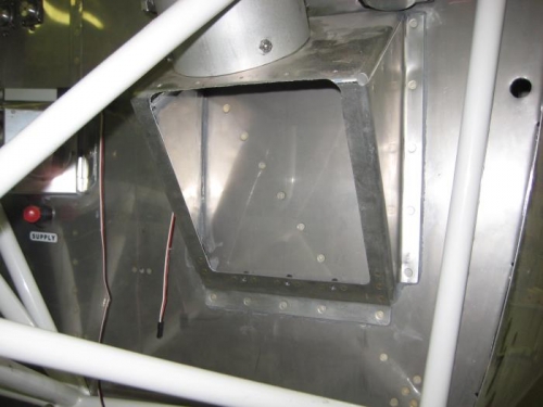

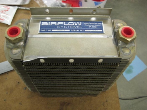

After much research, I decided to install an Airflow Systems 2007X oil cooler. This is a 15 row cooler instead of the Vans 13 row. A small modification was required to the stock cooler mount to facilitate mounting.

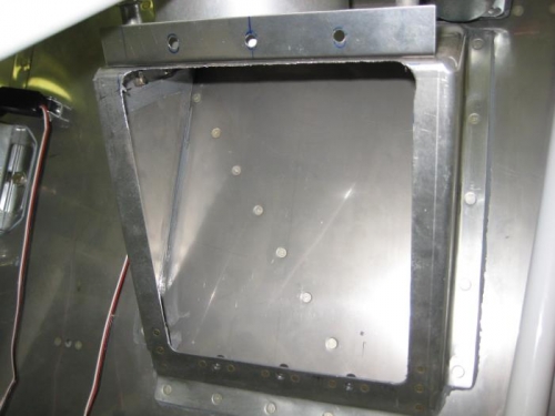

Fabricate mount angle from 025 stainless.
Drill angle fr mount holes and rivet holes.
Install cooler with lower bolts and match cooler mount to upper angle.
Layout and remove upper section of cooler mount.
Grind and file edge of cooler mount to final dimension.
Verify cooler fit.
