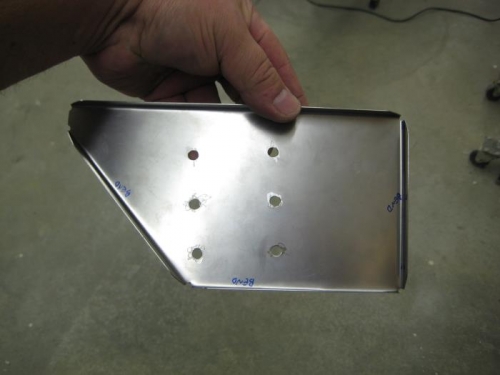

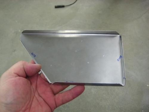

Fabricate additional firewall doubler for airwolf filter from 025 stainless, using shear and pan brake.
Smooth all edges of doubler.
Locate doubler on firewall and match drill airwolf bolt pattern using 1/4" drill.
Layout rivet dimensions on doubler.
