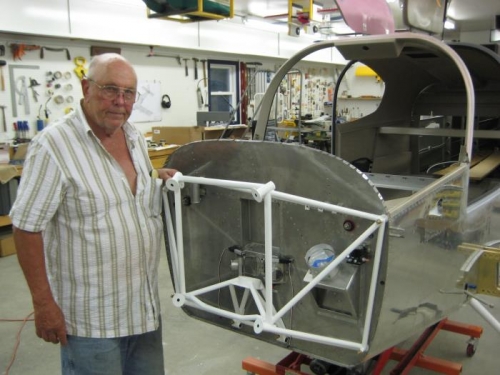

Install Engine Mount
1700 - 1900
Final drill engine mount hole in fuselage per plans using 3/8" drill.
Install mount with one AN6 bolt and tighten.
Using the mount as a guide, final drill remaining holes to 3/8", bolt and tighten as drilled., 5x.
