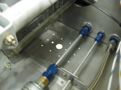

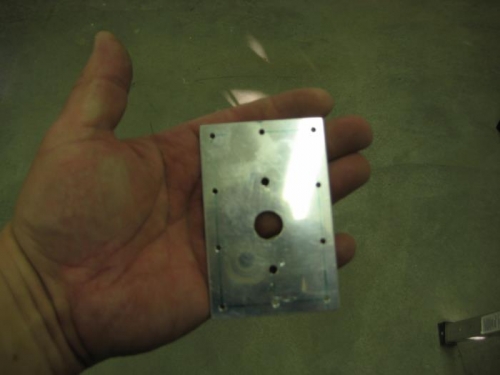

Fabricate doubler for COM105 transponder antenna from 063 sheet.
Position doubler on fuselage skin, left side, under forward seat. This location was chosen to comply with antenna location guidlines.
The skin was the match drilled to the doubler.
All holes were deburred and machine countersunk where necessary.
