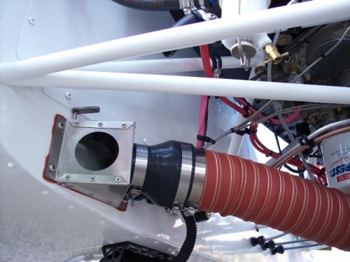

Brief Description:  Installing Cabin Heat Box/Tubing
I received the back-ordered SCEET tubing this week. All that is left for the cabin heat system now is connecting the end of the control cable to the box lever.
I was lucky enough to find some 3" diameter Adel clamps on Ebay. These helped hold the long length of tubing to the frame members.
I used a small stainless steel T-Bolt band clamp to hold the tubing to the bottom of the exhaust heat collector instead of the screw clamp supplied with the kit due to the heat and vibration in this area.
T-Bolt clamp on cabin heat tube.
Large Adel clamp securing SCEET tubing.
Under left side looking up. Selector lever not yet connected.
