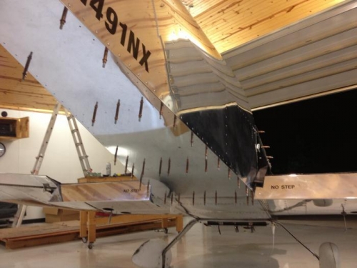

Worked on getting the bottom skin installed on the tail cone. Easily cleco'ed into place but spent a lot of time getting the spacers and angles right in order to install the screws at the mating plate the front and rear fuselage. Ready to be riveted. Going to have to order more rivets this coming week.
Bottom Skin ready for rivets

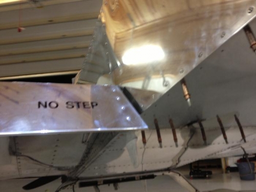

installed AN525-10R12 screws to mate the front and rear together

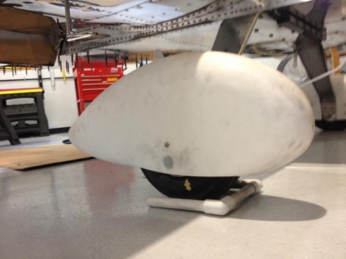

Installed Cap to access valvestem
