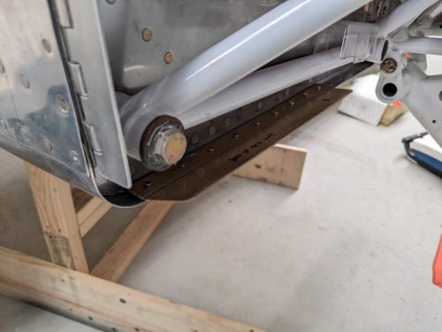

Yesterday I took my bottom cowl brackets to work and, using the hydraulic sheetmetal folder, put a nice neat bend in them. I needed to do this to accomodate the fact that the bottom cowl-to-fuselage interface isn't straight. The cowl slopes up away from the fuselage along the bottom edge. Anyway, with a bend in the brackets the cowl should now sit flat at the bottom edge.

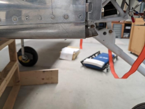

Tonight after work I rivetted the brackets in place along the bottom edge of the firewall flange. I had to use oversized "oops" rivets as I enlarged most of the rivet holes when drilling them out the other day.
All good now.
Here you can see the upward bend in the lower cowl bracket
The right side bracket rivetted in place.
