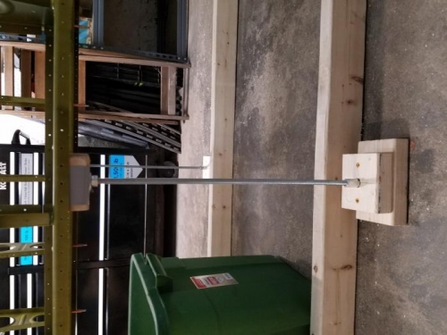

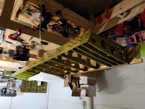

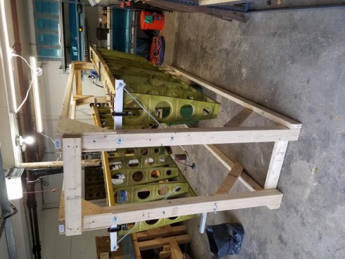

In this work session I completed riveting the ribs to the spar by riveting the inboard ribs to the right wing spar. Then I clecoed and riveted the rear spar to the right wing structure, then secured the right wing to the wing jig. I also built the mid wing support jack from wood blocks and a 3/8" threaded steel rod.
