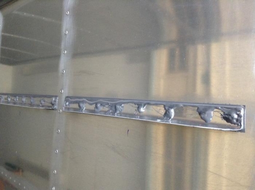

Stiffener
Stiffener

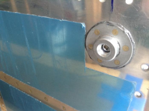

Drain installed
Drain installed

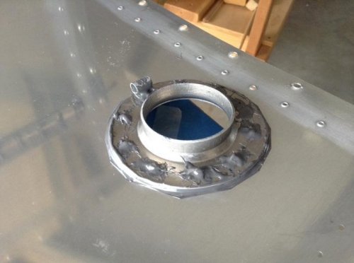

Fuel filler installed
