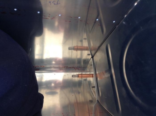

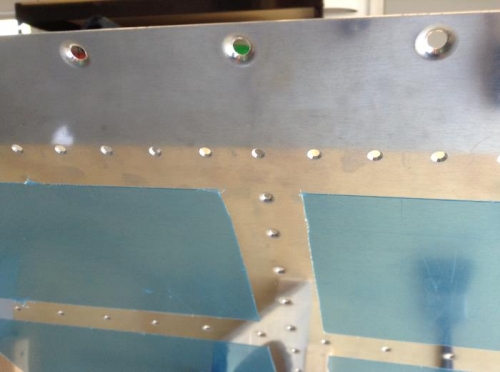

Setting up and dimpling tank skin. Checking on W-919 join plate - need nut plates on plate.
Fit and drilled holes for T-410 doubler to the outboard rib. Also need to rivet small plate over machine hole on rear / spar side of rib. (this will be sealed with tank sealant when assembling tank.
Had to reinstall three tank ribs to insure shape and fit.
Dimpled all rivet holes and #8 screw holes (Used tank die for rivets and #8 die set for screw holes)
