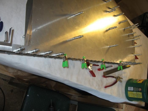

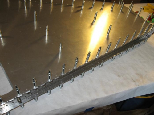

Tonight I got the vertical stabilizer hinge installed and drilled. It was kind of a chore because I had to make sure it was setback half of the total hinge diameter, which measured out to be 3/32. During the process I found myself measuring before and after drilling each hole, to make sure no curve or warpage crept in. It ended up being pretty much dead on, I think (won't know until I mate it to the rudder hinge).
I also made it hard on myself at first by trying to measure the top of the hinge to the top of the stabilize, which is supposed to be 1". Once I realized that each hinge loop needed to be centered on the pre-drilled skin holes, I just aligned to that and all was well, and I'm right at the correct 1" distance from the top. I'm finding a lot of work can be taken out depending on how you measure and align things!
Updrilling the skin & rib holed from 3/32" to 1/8" went without issues, as expected.
Hinge Alignment and Drilling
Hinge Installed
Hinge Installed
