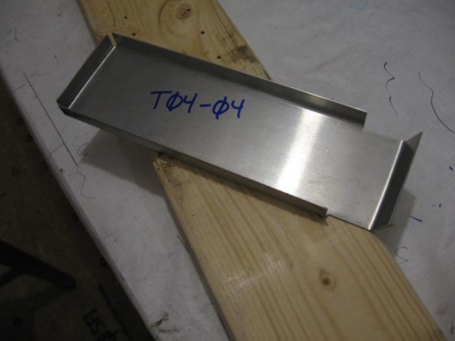

I also started fabricating the horizontal stabilizer ribs. I made the shortest one this evening (T04-04), I think it came out great; it looks pretty close to dead-on the full size plan drawing. I think I'm getting better at judging these things, and making parts seems to be going more quickly.
