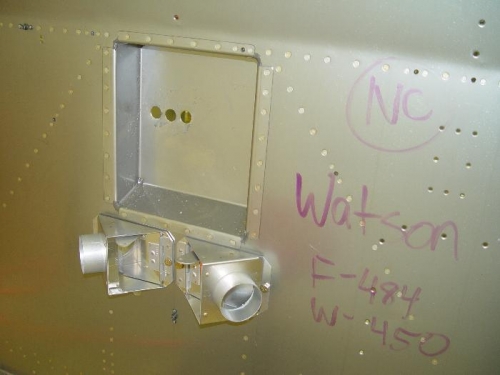

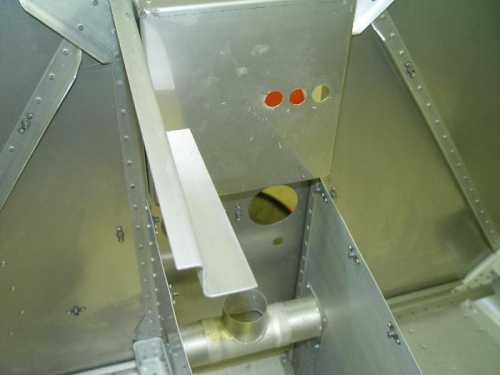

QB Fuselage Firewall work Inspected QB work Complete 27-2 step 3 by drilling 3 holes in firewall recess to 5/8" Found that F6122-1 Tri-gear Brake Bracket was not installed in QB fuse nor listed in Fuse parts list. Called Vans - Ken said he would send missing part. Bolted on Heat Selector boxes

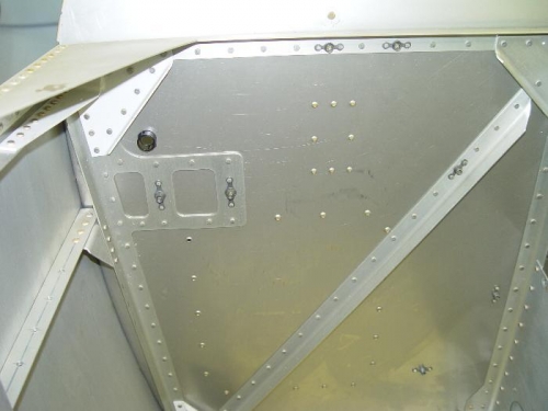

Showing spot where F6122-1 should have been installed
