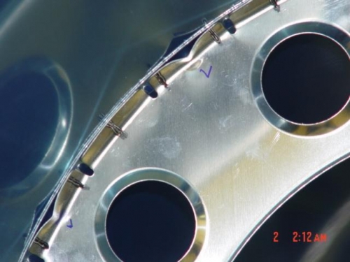

Brief Description:  Match drilling turtledeck stiffners
Match drilling turtledeck stiffners - It took several fittings to determine what "flute aggressively" exactly meant. It seems that that the clecos stand straight once you've fluted enough - see pic
Aggressive Fluting in Tailcone
