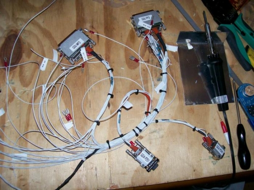

Date:  7-7-2013
Number of Hours:  4.50
Brief Description:  Avionics
More connecting wires. I decided to mount the GMU magnetometer and connect the wiring. Finished connecting and it crashed the GSU. I played with this for an hour and found I had a couple of pins in the wrong place. Corrected them and it worked great. I am not able to calibrate the GMU without a GPS antenna connected and I don't have one yet. I ordered a couple.
