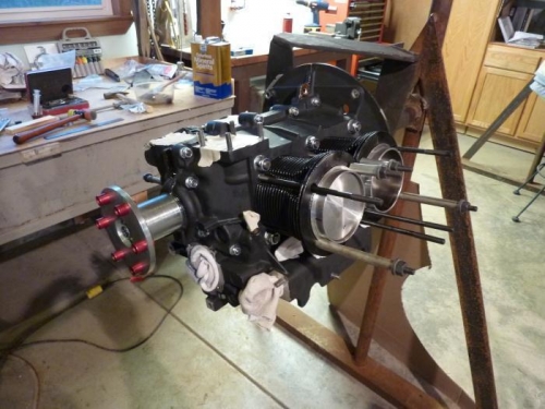

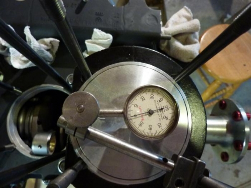

Brief Description:  Took Measurements fo 7:0:1 Compression Ratio

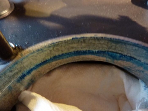

Temporary install of cylinders for compression ratio. I decided to go with 7:0:1 so I could use car gas. Had one jug that did not fit well into case(you can seebluing in picture 2) and had to do a little sanding. Packed case with rags to keep sanding fines out. Held jugs in place with two spacers and nuts snugged down for taking measurements. Ended up with .250 " worth of shims. Note: make sure you clean up the shimis before installing-they a stamped and have rough edges that could allow for oil leaks at base of cylinder.
Checking amount piston rises above cylinder at TDC
Area cleaned up so jug would go into case
On engine stad with one jug in place
