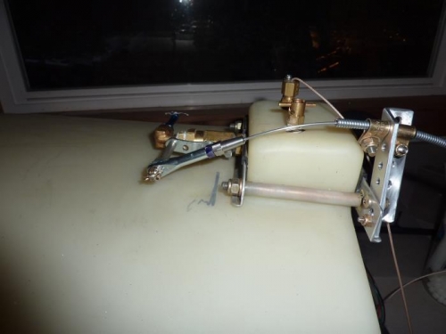

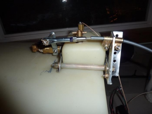

Brief Description:  Removed Fuel Tank for New Shut Off Valve Actuator
Did not like the original fuel shut off valve that I fabricated so I removed the tank and made a new one. Used left over piece of mixture .063 solid wire cable with wire grip for much mor positive control. Smoother action and open/close handle will be located on bottom center of instrument panel.
Side View Valve Closed

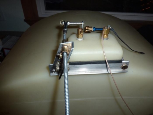

Side View Valve Open
Longitudinal View
Longitudinal View
