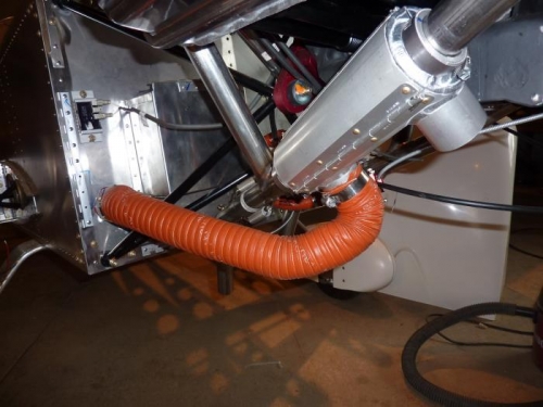

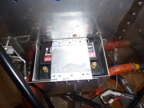

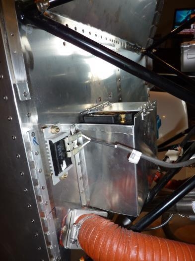

Brief Description:  Installed Cabin Heater/Vent Duct and Battery Box
Installed cabin heater kit from Airward. Can also be used for fresh air in warmer weather. Fabricated and installed battery box for Odessey PC625 battery. Found out after the fact that it is better to build and install the battery box before attaching other components to the firewall
Heater on starboard exhaust with 2
Heater on starboard exhaust with 2" sceet tube to heater control box
