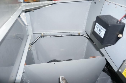

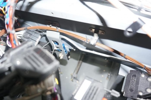

Removed avioinics shelves and Installed a standoff on the RH side of the avioinics bay bulkhead and bolted an adel clamp to it to support the EGT and CHT wires for cylinders 1 and 3. String tied with wires
Installed expandable sleeveing over the cylinder 1 and 3 EGT and CHT wires and Mag P-leads. Clamped the wire harness back in place.

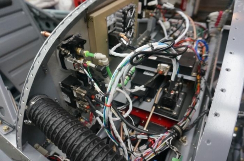

Removed the panel and replaced the remaining zip ties on the wire harnesses and pitot-static lines with string ties.
Replaced the avionics shelves and started to reinstall the panel mounted equipment in preparation for a powerup test once the firewall mounted primary powerwiring is completed.
