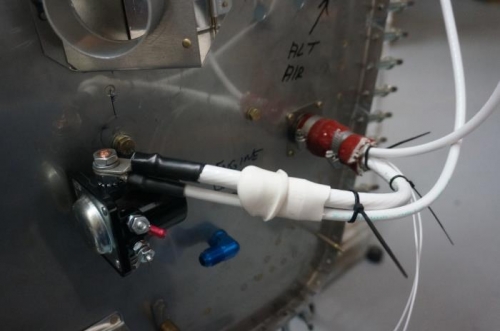

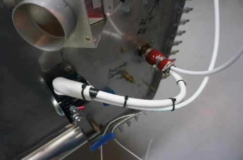

Main power wire hook up to starter contactor
Cut the main power wire to length and crimped on a #2 5/16" ring terminal.
Cut a length of #6 wire and terminated it with a 5/16" crimp on ring terminal
Unbolted the starter contactor, turned it 180 degrees and reinstalled it. This position will put less strain on the main power wire.
Installed both wires on the starter contactor
