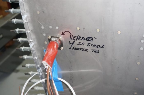

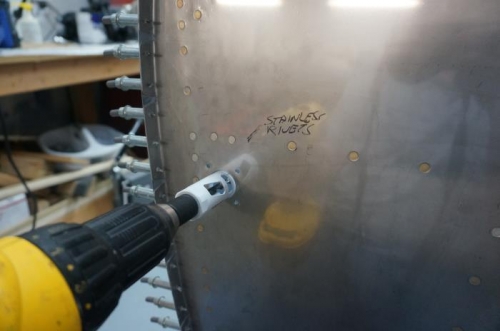

Cut a 1 inch hole in the RH side of the firewall using a hole saw. This hole will be for the magneto P-leads and the EGT and CHT wires for cylinders 1 and 3.
Drilled the attachment holes for a 3/4 inch pass-through fitting. Temp installed the fitting.
Drilled holes and installed two standoffs for Adel clamps to hold the EGT, CHT and P-lead wiring.
