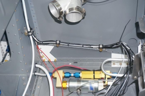

Continued working out the wire routing from the avionics bay to the firewall.

Installed two standoffs on the LH lower forward longerons.

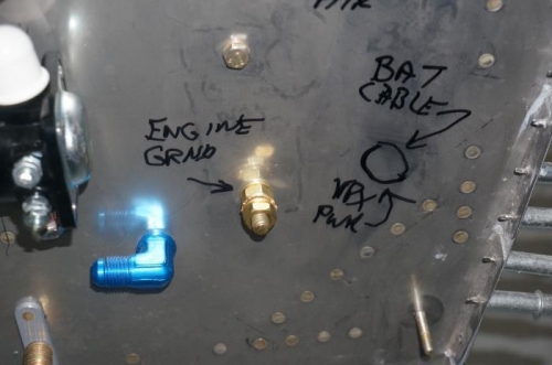

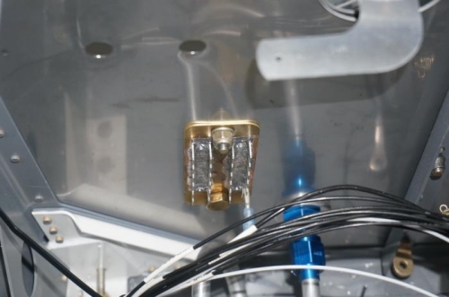

Drilled holes in the firewall for the "forest of tabs" ground block and bolted it in place.
Mounted a standoff on the forward side of the LH landing gear tower to support an Adel clamp.
Terminated the ground wire from the avionics bay ground block with a spade connector and plugged it on the firewall ground block.
