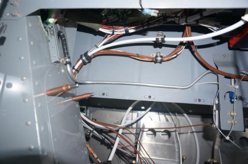

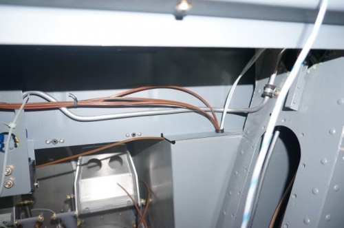

Worked on the wire routing for the wires that go forward to the firewall. String tied the wire bundles on the LH side. Riveted two standoffs to the avionics bay forward bulkhead to hold Adel clamps which will support the wire bundles.

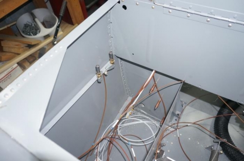

Drilled a hole through the avionics bay forward bulkhead on the RH side and installed a snap bushing. Passed the EGT and CHT wires for cylinders 1 and 3 along with the magneto P-leads though the snap bushing into the forward baggage compartment.
Wires routed in front of LH gear tower
Wires for RH side of engine
