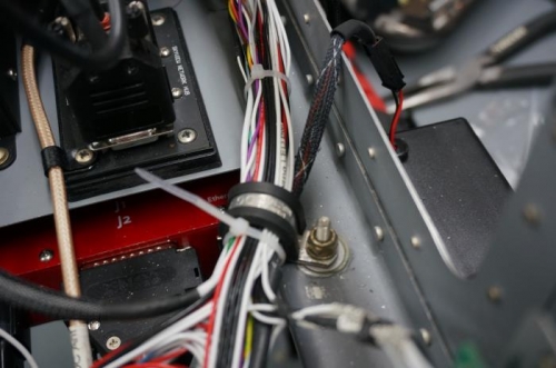

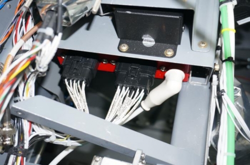

Installed Adel clamps on the click studs bonded on last work session. The Adel clamps support the main wire harness in the avionics bay.

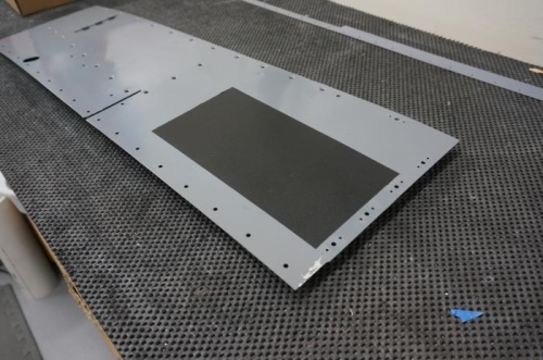

Masked and prepped for paint an area on the RH cabin floor where the rear passenger's feet will run with they enter and exit the aircraft and if the pull their feet back during flight. Painted the area with truck bed paint. Let dry for an hour and removed the masking.
Adel clamp for main avionics bay wire harness
