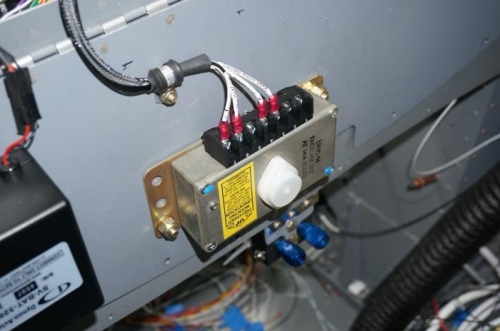

Mounted the voltage regulator to the avionics bay access door. Terminated the wires with ring terminals. Installed expandable sleeving and shrink tubing on the wire harness service loop to protect it from abrasion. Hooked up all terminals and installed an Adel clamp to secure the harness to the door.

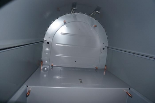

Painted and bakes the Aft baggage bulkhead

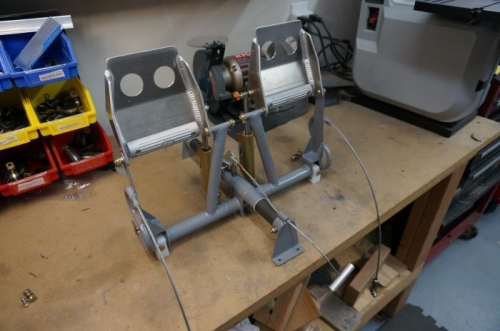

Reassembled the rudder pedal assembly.
Voltage regulator mounted and wired
Aft baggage bulkhead completed
Rudder pedal assembly
