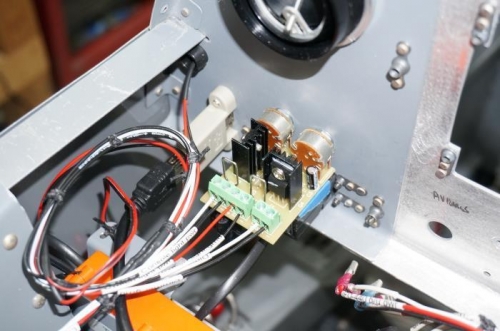

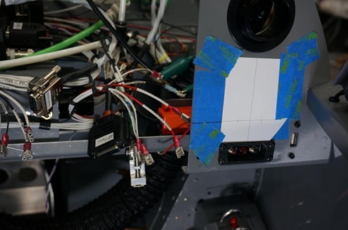

Laid out the locations for the dimmer switch knobs on the sub-panel. Drilled pilot holes and then opened them up to #19. After that I used needle files and round files to open up the holes so that I could adjust the hole locations as I went. Deburred the holes and installed the dimmer and knobs.
Routed the dimmer ground wire from the avionics bay ground block to the dimmer. Routed the dimmer power wire from the VP-Pro to the dimmer.
Spliced the switch light wires together and the console light wires together. Tied all of the wires together to make a harness, looped the harness to make a service loop and installed the wires in the dimmer. Functional test was A-OK.
Holes for dimmer layed out
Dimmer and knobs installed
All wired up
All wired up
