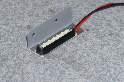

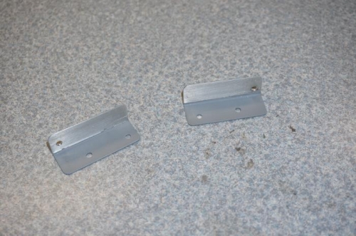

Located the console light brackets on the aft landing gear tower cross brace and match drilled the brace with a #30 hole which will be used to fasten the bracket to the brace with a blind rivet. This all took a long time in order to make sure the holes in the cross brace had sufficient edge distance.
Concole light brackets
Console LED light in place on bracket
