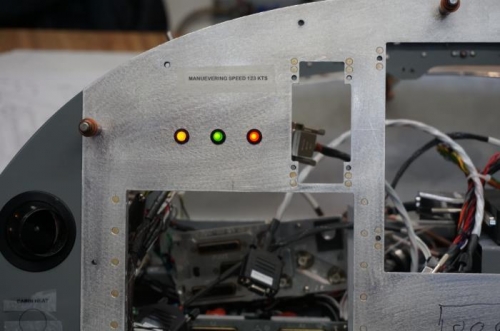

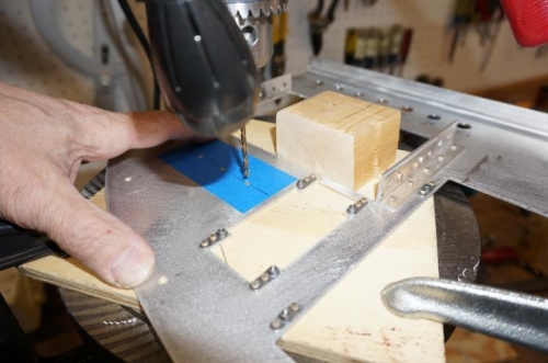

Laid out the position for drilling the three indicator lights. Fabricated a fixture to hold the panel in the drill press to facilitate drilling all three holes in a straight line parallel to the bottom of the panel. Carefully drilled each of the three holes starting with a #30 and working progressively up to the final 24/64" drill.
Deburred the holes and test fill the indicator LEDs. They fit well and are lined up perfectly (or close enough to my eyes). Removed the LEDs.
Scuffed, cleaned and primed the panel.

Fixture for hole positioning
Success
Success
