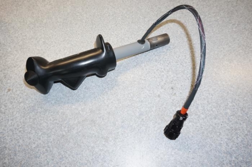

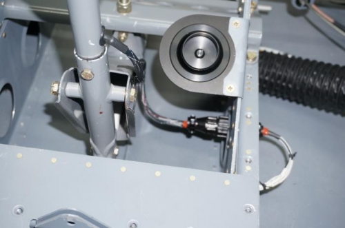

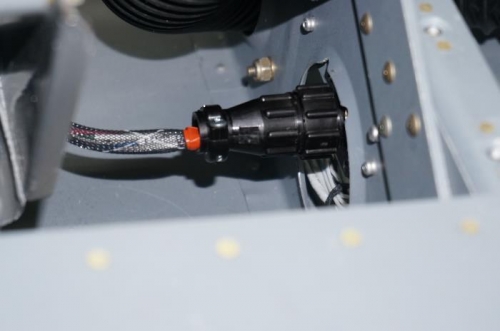

Cut and terminated the rear stick grip wires with D-Sub receptacles. Installed braided sleeving shrink tubing and connector back shell. Installed stick in airplane and connected the connector.
Completed stick
Stick and wiring in place
CPC connector
