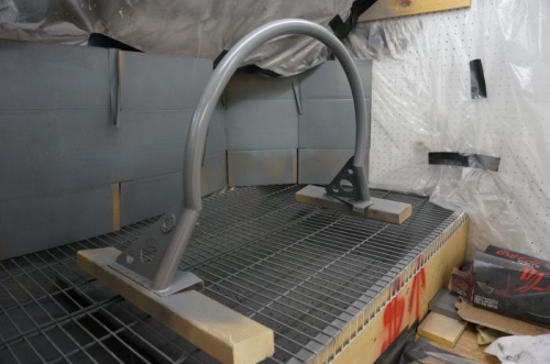

Scuffed, cleaned and painted the roll bar with Dark Machine Gray paint.

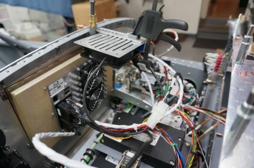

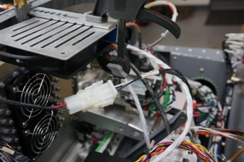

Cut, labeled and routed the avionics fan ground wire. Routed the wire along the main wire harness to the avionics bay ground block. Temporarily clamped the avionics fan in the general location where it will be mounted on the glare shield. Cut the power and ground wires to length. Installed braided sleeves and shrink tubing and terminated the ends with molex connector pins.
Configured the VP-X Pro to turn on the avionics fan when the avionics switch is on. This fan will remove some of the avionics generated heat from behind the panel and will also serve as a defroster for the front of the canopy.
Painted roll bar
Painted roll bar
Avionics fan wired up
Molex connect for fan
