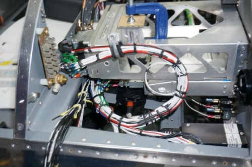

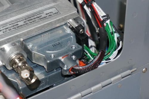

Brief Description:  Completed wiring IFD440
Finished all of the wiring for the IFD440. Spliced the com power and ground wires to the wires from the IFD440 connector. String tied the bundles together. Terminated and installed the shield grounds. Bonded a click stud to the top of the IFD440 mounting tray to support a P-clamp.
IFD440 shield grounds
