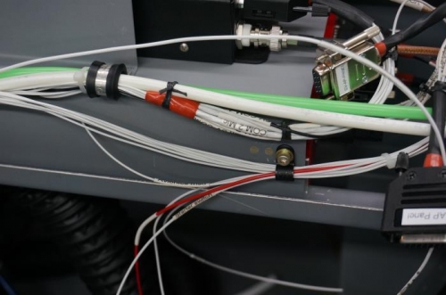

Brief Description:  Nutplate for switch wiring clamp
Removed the SV-COM-425 shelf. Drilled and riveted a nut plate to hold a plastic P clamp to secure the switch wires on the LH side of the panel. Re installed the shelf and the equipment mounted to it.
Clamp to secure switch wiring
