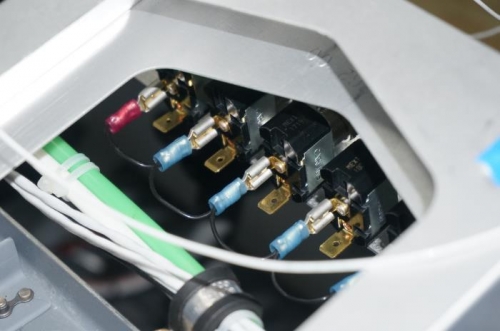

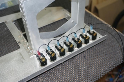

Fabricated a wire harness for the ground wires for the VP-X pro switches that are mounted to the left of the panel.

ground wires for VP-X pro switches

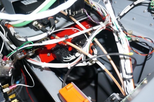

VP-X Pro J2 D-sub backshell (under J1)
