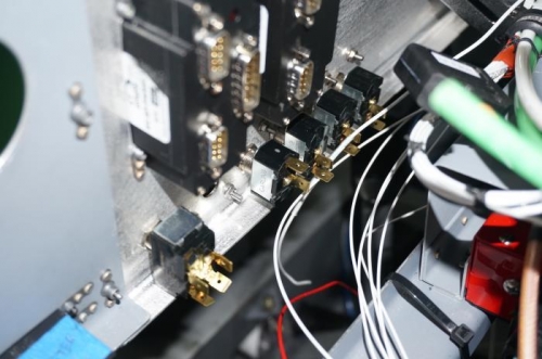

Cut the switch wires for the ALT switch, auto pilot switch and avionics master switch to length, labeled them and terminated the VP-X pro end with a D-sub pin.
Drilled an additional hole in the panel between the holes for the BAT switch and the LH mag switch for a starter enable switch. When I had the panel cut by Stein Air I was thinking that the starter enable switch would be under the panel out of sight but I have since decided that it makes more sense to put it on the panel
Installed the switches and switch guards on the panel

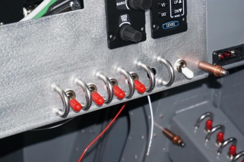

Engine switches

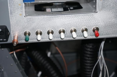

Light etc switches
