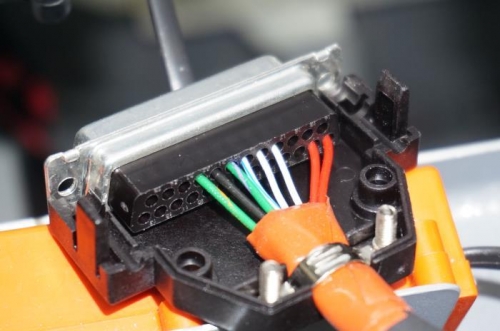

Cut the flap sensor wire to length and installed a new label. Stripped the outer insulator and shield from the end. Installed D-sub receptacles on the end of the three flap sensor wires and installed the pins in the J1 connector.
Cut the power wire for the front seat lemo connector to length, installed a new label and installed a D-sub receptacle. Pinned the receptacle into the connector.

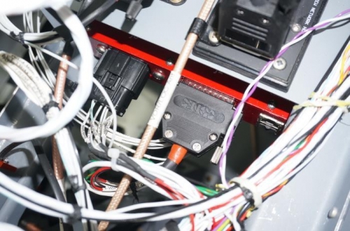

Installed the backshell on the J1 D-sub connector.
VP-X Pro J1 connector pinout

Backshell in place
Backshell in place
