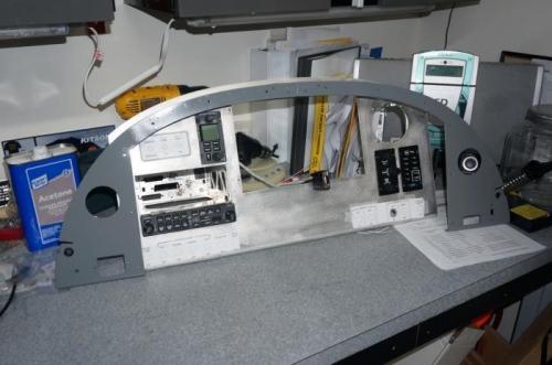

Wet sanded the sub-panel one more time and then sprayed it with two coats of paint. This time I first ran the exhaust fan in the paint booth to remove all of the dust. It seemed to make a difference and the panel looks much better than the last attempt.

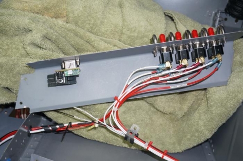

Terminated the ends of the remaining wires that connect to the backup switches in the E-bus circuit. That included the power wires from the VP-X pro for the landing light, boost pump, com 1 and pitot heat plus the wires that run to each of those components. Crimped ring connectors to the wires and attached them to the switches.
Painted sub-panel
Painted sub-panel
Wired up backup circuit switches
