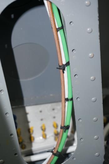

Tied the hoses, wires and coax in the LH gear tower to make a bundle.

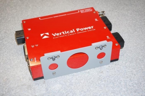

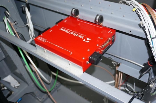

Fabricated a bracket to bolt the forward side of the VP-X Pro electronic circuit breaker to the F802N upper forward brace, The aft side of the VP-X Pro will attach to the angle bracket which was supplied with it and the angle will mount to the F802T crossbar.
Hose/wire/coax bundle in LH gear tower
VP-X pro forward mounting bracket
VP-X pro mounted in the fuselage
