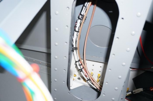

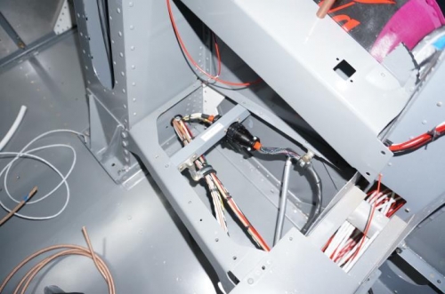

Terminated the yellow autopilot disconnect wire in the RH mid-cabin brace harness with a D-sub pin and installed in the RH Mid-cabin brace CPC receptacle. Installed a strain relief on the CPC receptacle.
Riveted the RH mid-cabin brace CPC connector support in place.

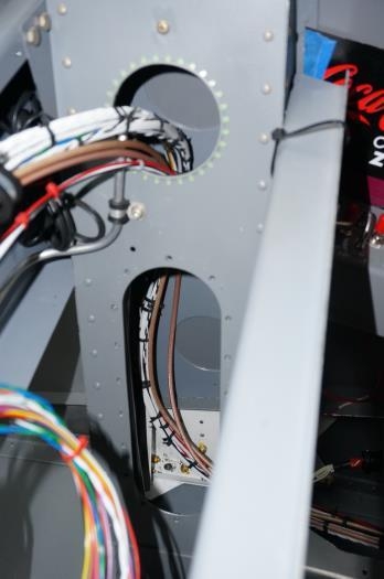

Spent the rest of the day straightening out the wires in the RH gear tower and tying them into bundles.
Completed wiring in RH mid-cabin bace area
Wire harnesses through RH gear tower
