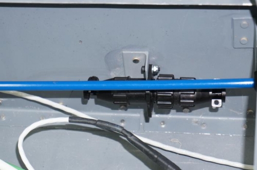

Painted the bracket for the LH wing pitot heat and stall warning CPC and riveted to the LH fuselage skin.
Drilled holes through the two intercostals under the floor to route the wires from the LH wing, along the RH side fuselage sides, and throught the spar.Installed a few adel clamps on the fuselage sides to support the wires for the
